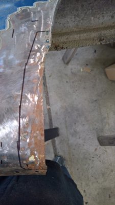

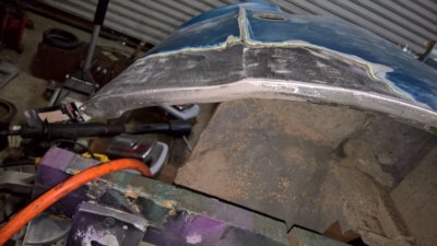

Haven't posted anything in a while so I wanted to show that I'm finally working on my road runner. Started first with the fenders, had to fix where someone cut and rolled the front lip on the fenders for bigger tires??? Picked up a 69 for parts and cut what I needed off of that and welded up mine. Turned out pretty good!

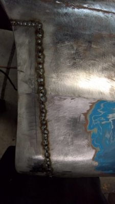

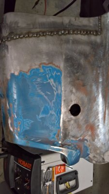

lucky no rust on fenders only other thing I had to do was weld up the antenna hole that was cut in it.

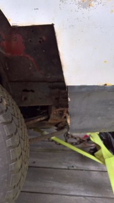

Next moved on to engine compartment to fix the 50yrs worth of holes cut into the firewall!

Anthony look's good man. I had to replace my quarter's and drop downs also or should I say at least 3/4 of all sheet metal on the car. It was a rust bucket. Keep up the good work and keep us up on the progress. Oh after your last post about fire wall wonder if a butcher jobber owned it before you. I feel for you and hope it get's better buddy. Russ.
