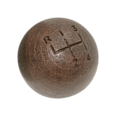

?????? Here is the shift pattern.
69 only has one location for the shifter. 70 and up has 2 locations for the shifter to mount to. This change was made for E bodies.
