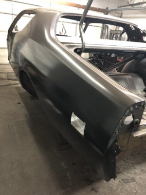

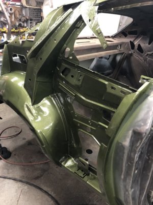

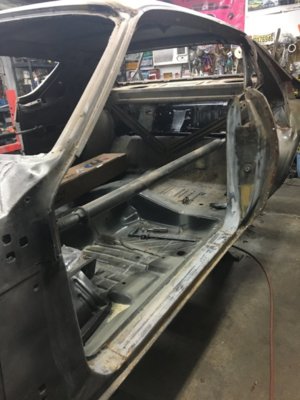

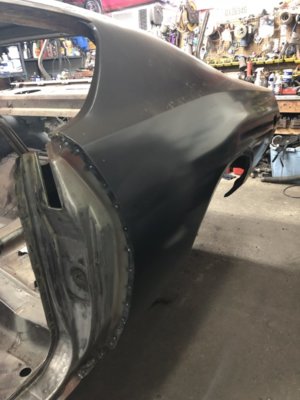

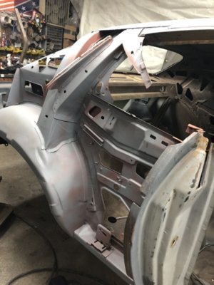

Passenger quarter hung, tacked into place a few days ago. Over the past two days I hung the doors and fenders temporarily to make sure the edges of the quarters had the correct contours to the door edges. Finished final spot welding on both sides. Started work on the doors and fenders today and did the lead work on the tops of the quarters at the roof seam

I buy a great deal of my supplies from Eastwood, then some things like the paint at the local Kemperle auto body supply. In the case of the lead, I used the Eastwood lead kit, which uses 70/30 lead sticks. You might be thinking of the "lead free Solder" but I don't trust that stuff. The real lead flows nice, shapes nice and makes for a great foundation at those critical seams. The hard part is getting the area really clean, especially in all the little recesses and between the welds.

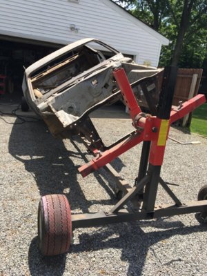

If I had a dipper nearby I would have gone that way and saved myself a LOT of work. However living on Long Island NY, the environmental and government know it alls have all but killed all of those industries. So, the only commercial method out there for me was to either send the car to someone who will media blast it OR use one of those Dustless Blaster guys who come to your house, set up and do the work there. I called the local Dustless guy and he wanted $1400 to do the car so I decided to just do it myself. It took two or three days and what I did was weld some trailer hubs I bought off ebay onto the ends of my rotisserie, and mounted some old golf cart tires I had laying around from a lift I had done on a friend's golf cart. That allowed me to roll the whole assembly out into the gravel. Then I used a wire wheel on my grinder to get off the big rust and scale. Next I used a pressure blaster I bought at Harbor Freight tools and a 50lb bag of glass bead, mixed with a 50lb bag of silicon Carbide to cut through the medium paint and rust. Then finally I went over everything and the panels with just light paint with a soda blaster and a 50lb bag of soda I bought at Harbor Freight tools. It worked, but what a mess and a lot of time and work. When it comes time to do the 69 Roadrunner I have, I am going to bite the bullet and pay the Dustless Blaster guy to come and do it. I saved money for sure but I missed spots and had to go back over them, and for weeks every time I moved the car around to weld, out some more glass bead or soda that was hiding up in some area. And I cleaned the car three times, still there was residual blasting media. Lesson learned. This car has been by far the most involved restoration I have ever done and I have done many over the years. I have done restoration work for myself and for others for over 35 years. This one was big and I wanted this one to be better than any other before due to the rarity and value of this car.

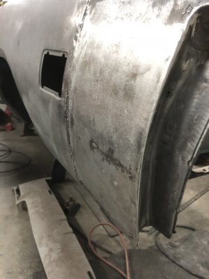

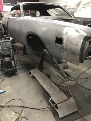

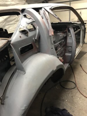

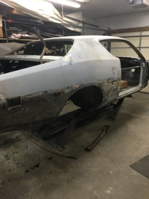

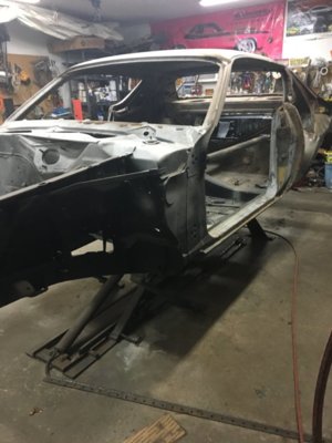

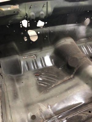

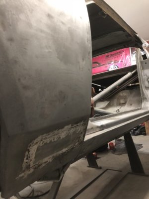

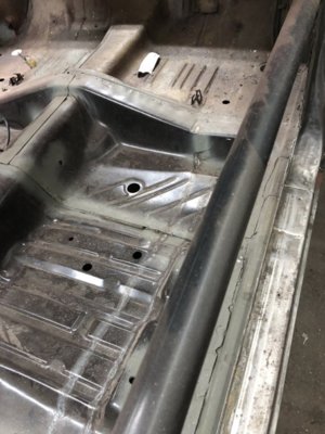

So, been a few days since my last post but I have been working every day on this project. As of last weekend, front and rear full floor pans done, full trunk pan and both drop downs done, both full quarter panels done. Now onto the removable panels- both doors, both fenders and the trunk lid. Forgot I never finished stripping them before it got cold out so as weather has allowed I have been blasting them on all sides. Of course found hidden old work that I did not know was on my so called “clean panels” so now I am doing repair work to them as well. On the right front fender it must have been hit at one point and repaired as a collision job. I found 14 holes drilled under body filler, holes used to attach a slide hammer from the outside to pull out the dent. It was like damn Swiss cheese dripping with body filler. So, I opted to cut out the whole section and weld in clean metal and grind smooth. Found similar holes in all 5 panels but nothing like this. So every panel has required metal repair and hole welding but today I am hopefully wrapping them up and getting them to bare metal. Here are some shots. My goal is to finish everything up by mid week next week so I can clean up the work area and prepare to apply epoxy sealer primer to the whole car and all the removable parts. Then the work of smoothing everything begins.
