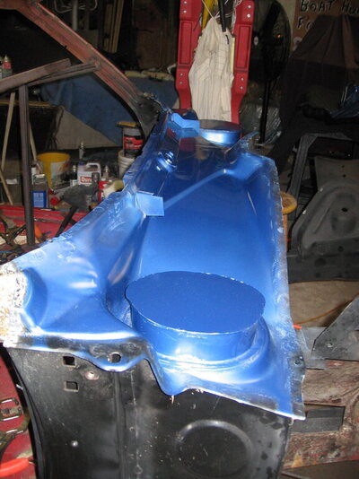

Paint gun spit is probably the nozzle peace behind it gets plugged. During painting the hole gets dried paint in it. Ask me how I know. I used a sheet of constructions paper too test spray the gun before applying paint to the car. Do you find that the holes for wiper pivots don't line up well. It is a lot of word buddy. Replaced upper and lower cowl on my runner. Use Harbor freight guns alsoIMG_0101.JPG
