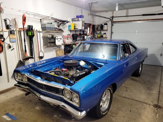

Anyone know what the empty and full ohm values are on a 68 roadrunner fuel gauge? I'm wanting to buy a 20 gallon fuel cell with the correct sender ohmic range. Thanks!

73-10. 10 being full
Thanks for that. I'm looking to get a new 20 gallon 70-10 ohm fuel cell. Some show fittings on top and bottom like mine. Others show both fittings on top. How does that work? Also some have foam, others don't. Is foam recommend?
