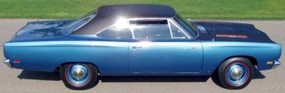

I was not sure where to post this but Ive been looking at using the original hideous hub caps on my car, they are faded with little to no paint, and i need some smaller projects while I pay off big ones. So Im looking for pics that these caps are were used on. I found a image on line that must be a likeness of the caps colors, looks like a flat black tab and maybe a argent type darker gray silver similar to 72 Rallye paint, but i need to be sure because I want them to be right. If any one has pics or is using these Horrid lol things, please post me some pics back, Thanks

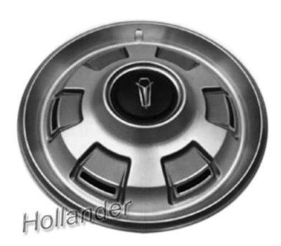

Those are not correct for a 1969 RoadRunner. They do not say "Musclecar" The attached with the black center and Plymouth Division in silver are the right ones. They look a lot better too!

You won't find a photo of a RoadRunner with those on it. There have been one or two RoadRunner owners who are certain their car came with them and they may post a photo but regardless, they are really Satellite and Belvedere caps. The RoadRunner hubcaps are called the "Sport" hubcaps. You can find some that look similar but it's a little harder to find the ones with the black center.

Can't open your attachment but the Sport ones with the black center and Plymouth Division name are the standsrd ones for a 69 RoadRunner, Sport Satellites, 69 Barracuda Formula S cars and I believe also the 70 RoadRunner. The news is that I found the OP's hubcap listed as available for RoadRunners p/n #2823010 so it is possible that they are original to that car. I'm just going to say again that I never saw a RoadRunner with them back in the day and I checked out a lot of RoadRunners in my time?

Where did you find that Part Number and info for those caps, wasnt quite sure what OP abbreviates....Ive had the sport caps with the black centers they say Plymouth Division for over 30 years, when i got the car I put one on the front just to see what it looked like, and I preferred it to the caps that were most likely used on the Belvederes. Great Big Learning curve here....But if you have a good resource Id like to see it for future reference. Thanks for the input, only way to get a question answered.

OP=original poster. The hood scoop emblem looks like it says Hemi? There were no 15" factory mags so most Hemi cars came with the painted 15" steel wheel and dog dish hubcaps like in the photo. I got the information from the 1969 Parts Book. They have pictures and part numbers for the hubcaps in section 22 and when you look up the part numbers, it tells you what body style they are specified for. If you didn't order any hubcaps, the car came with body color painted wheels and dog dish hub caps (the factory just painted the outside face of the stock black wheels). The Road Wheels and the Sport hubcaps are what they showed on the RoadRunners in the 1969 Plymouth factory promotional literature.

I assume your car is not T7? You probably know the wheels would be black with full wheel covers. The bronze wheels would have come with the dog dish hubcaps. Since you don't know for sure and apparently think the ones that came on the car look hideous, why not just paint the wheels black and go with the full size Plymouth Division hubcaps?

My RR is a T7 Dark Bronze painted car, and the steel wheels were painted Dark Bronze under those caps that were on it, so its looking like after this discussion I may just drop those caps, and put the correct dog dish caps on it and leave it at that. I appreciate the discussion, In the mean time I will probably recondition both sets of caps and then test fit a dog dish cap. One question are you running dish caps? or the Plymouth Division caps with black centers?

John my '69 Road Runner hardtop that I ordered new in '69 had the same WHEEL COVERS as the photo you posted. I don't remember ordering them so they must have been part of the hardtop décor package. I found a set at Norwalk this past September and bought them for "garage art". I actually left them on for a long time while deciding between Keystones or Ansen Slots and always removed them when I went to the drag strip as required.

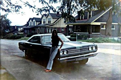

(if you look closely you can almost see the wheel covers on the rear of my Road Runner in this 1969 photo of my car)
