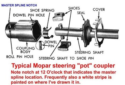

The dowel pin is missing, worn, or incorrectly installed. Otherwise it wouldn't have come completely apart.
The assembly is spring loaded. It might be easiest to remove the roll pin and and slide the coupler body off of the steering box, put it back together, and then slide back on the steering box. Here's an exploded view diagram to show you what you are looking at. Make sure that you get the shoes correctly oriented when you slide it back into the body or it will have unwanted slop in it.
thanks. that's what we figured was the answer. should we buy a new coupler kit? when we put coupler body back onto the steering shaft how do we get the coupler to meet with the steering box, since the telescoping steering shaft isn't telescoping very well?
