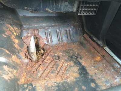

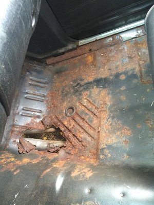

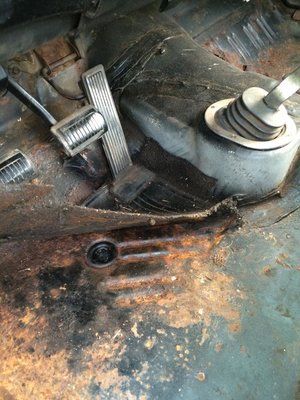

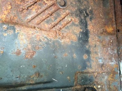

I have not removed the seats but so far it looks like I have surface rust on the whole floor pans (see attached pic)
I also have two holes in the front and left that need replacing and I'll buy the front and left pans to replace.
I do not want to replace the whole floor, its too much money and too much work.
The question:
What are the steps to remove the surface rust and how does one do it?
What tools do I need, what is the process, and what are the best, most affordable products to use?
I've done some research and so far I know that I need to remove the rust, vacuum all the dust out, and then cover the floor with Rust encapsulator paint....then sound deadener and carpet, etc. (Also if you have hints for patching the holes).
Anyone will experience doing this? Thanks!

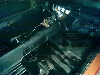

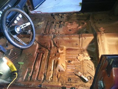

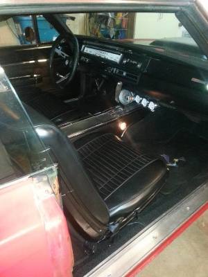

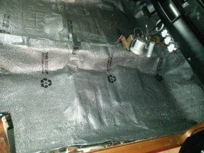

Good ol elbow grease, I used Rust Bullet after scrubbing, then protected and sound proofed that with lizard skin. Then some undercoating with heat shield and sound absorber built in. Then new carpet. Works great.
DirtyBird
Jun 30, 2015
54
California
Sweet! bigman, looks beautiful in that RR. Also I appreciate the pics as they always help visualize. You also opened my eyes up to spray sound deadening...I really only read about dynamat and fatmat, etc. What's the main difference between spray and mats besides say, less weight and ability to access non flat spots?? Anybody tried both and can comment? Also lizard is expensive and I don't really want to buy the spray can...

Btw what's that gauge setup you got? I originally though white gauges didn't fit but that looks very nice. (Here I go getting ahead of myself again...I gotta patch my floor first!!) :)

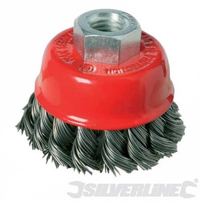

3. Do these wire brushes work well (when put on a drill) for getting rid of the surface rust?

When I did my badly rusted trunk I used a stiff wire hand brush, but that drill attachment should work just fine.

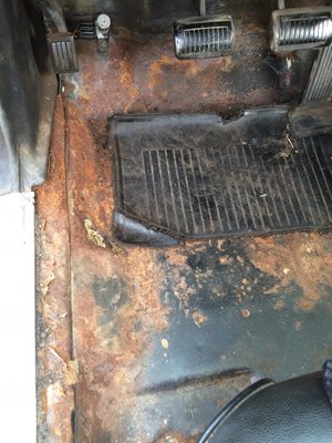

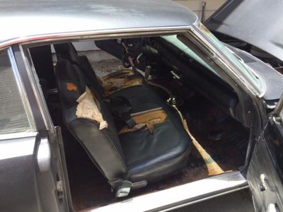

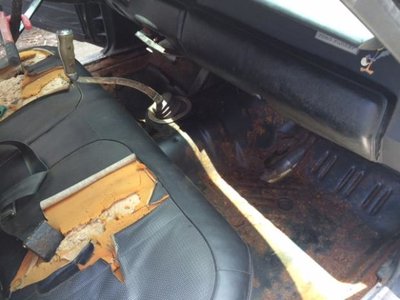

This is what I'm working with...Do I need to replace those thin side rail pieces too? What are they called?
quikbird
3,304
1,111
Sarasota, florida
Just the ones on the drivers side. They are the covers for the wiring harness going the rear of the car
