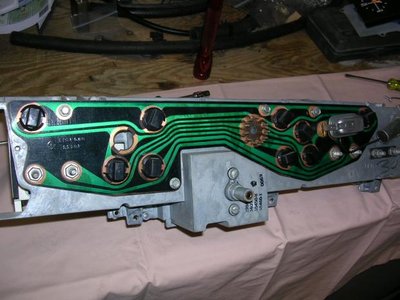

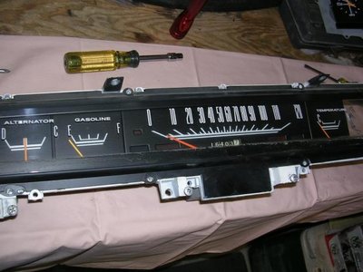

Not an easy job. Pretty much need to pull the cluster to get to it. MIGHT be able to drop the column and reach from under neath but probably need to pull the cluster.
The cluster has to come out. The gauge isn't accessible from the back. Here's a pic I stole off the intrawebs showing the rear of the cluster.

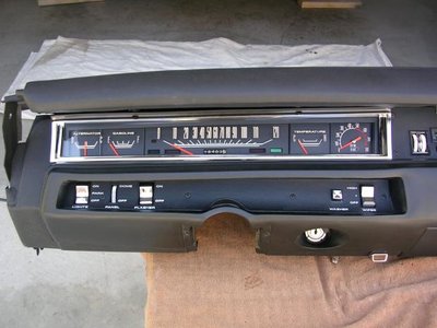

not the easiest way....but might just be the easiest way...pull the windshield, and pull the dash. the clusters and switch panel are a PIA to get out of these nearly 50 year old pads, and getting them back in is just as bad.

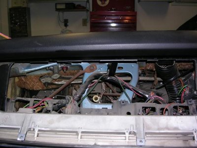

Lower the column pull the switch panel, and maybe the lower pad (its been awhile)to get to all the screws. Then its behind the circuit board

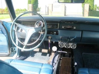

WOW..........Now I know why so many owners opted for the aftermarket gauges. NOT just because of the PIA of working with these gauges. BUT, the effort is NOT worth it, other than keeping it looking STOCK. The original gauges DO NOT compare to the aftermarket gauges in accuracy.
I thought about the POD that attaches to the steering column. I think I will look into maybe installing a TWO gauge pod. The OIL gauge and WATER TEMP gauge.

I'm now leaning towards installing two after market gauges since the car has an 'idiot' light for the oil pressure. I don't feel it is worth going to the trouble and NOT be happy with the results. I much rather have a dependable OIL pressure and WATER TEMPERATURE gauge......
The question now is finding a suitable place to mount them that I will be happy with.
