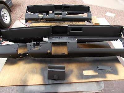

It rained a bit last night so the air was dust free and humid for us perfect for shooting Lacquer. The suede paint went down great 69 runner and charger dashes DSCN0775 (1024x768).jpg DSCN0775 (1024x768).jpg

Look Grate. We got rain here but the humidity is off the record. How durable is the lacquer. It looks about like what the black epoxy finish looks like that I have shot on to the car. Kind of a dull finish. Will you clear this when you are done or is that it. Russ.

It stays dull, this is the same type of paint the factory used. Who wants a shinny dash when the sun hits it anyway

Yep don't need the glare. May be thought their was a sealer you put over the lacquer. Thanks for the info.
