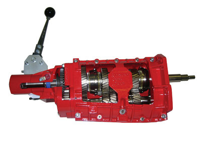

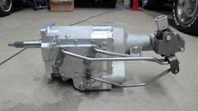

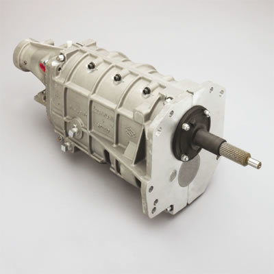

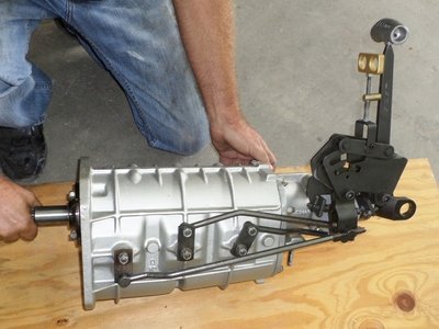

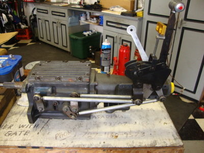

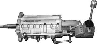

Passon 5 spd trans is now being produced
In very limited #'s so far after 3-4 years now, going thru multiple R&D sessions & suppliers etc. & you need to be on the waiting list {was 350+ waiting last I saw}, they are as rare as hens teeth too, I've personally actually only seen one guy who has actually has received delivery & installed one so far, over on FBBO {person was on Moparts, saw the link on FBBO}... might be a few more out there now... It's great if your on the list & can actually get one... Gear Venders are available & work great, been around for a while now too... good luck whom ever need one of the Passon 855 OD $3100-$3400 each, depends on when you got on the list or price changes... There's also Richmond 5 speeds & Doug Nash 5+1 too, some used ones here & ther like on Racingjunk.com, with one of them you can run like a 3.23:1 gear & have the performance of the 4.30:1-4.56:1 type gears, with still a 1:1 final drive gear, because of a lower 1st & 2nd gear ratio in the 5 speed trans, much cheaper too, with little to no waiting, depends on what you want, how much work & what's the budget, there're a bunch of transmissions out there, like Jerico or Tremec too...
