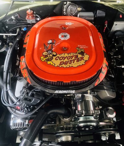

I have a Borgeson steering box that bolts right in; an Ididit tilt steering column; belt driven power steering mounted directly behind the AC compressor. You can get all this as a kit or piece it together. With exception of the steering box and column, I went the kit route to be sure everything fit. There were a few challenges along the way getting the steering column to fit the steering box.

Correction to my recent post. The power steering setup is mounted immediately below and next to the AC compressor (I've attached same photo for clarification).
