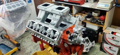

Yeah Russ, I had been slowly buying parts for the upgrade for about a year, and taking the car to the track every now nad again for some fun in between. Blew one of the caps in my diff at the track, so decided to move on up to aa Dana 60 - big unexpected cost.
WHilst the trans was out, took the afermarket alloy heads off for a service, found 2 hairline cracks where we had clearenced for bigger pushrods. Fixable, but money better spent on bigger heads - also big unexpected cost.
All these unexpected costs are starting to take a toll. But when I walk into the engine room, and see this, it all gets better so fast.thumbnail_IMG20200408154024.jpg

Yes that would make my day also. Sorry to hear of the bad luck. But can say that is the cost for going faster. Know all about braking parts on a drag car. That is why the big boy's have sponsor's. It is costly to have fun. Maybe you have it all in line now. What time's are you turning on the track. :thumbsup2:
