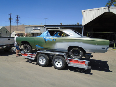

There she is. After 15-years the bird is out of my possession as it is away for an overnight stay at the media blasters. So I'm naturally a little anxious over it. It's not the better part of town, but not much left on the car for the taking either. Anyway, they're not blasting the whole car, just a few trouble spots throughout the interior. Oh man! I hope I get it back in one piece. Bites nails.

always a stressful time when your baby is in someone elses care that you know just not looking out for the car the way you do

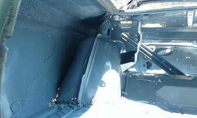

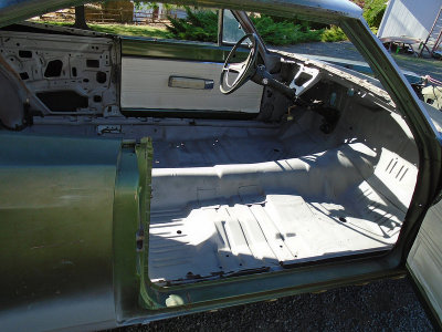

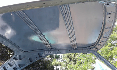

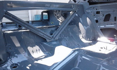

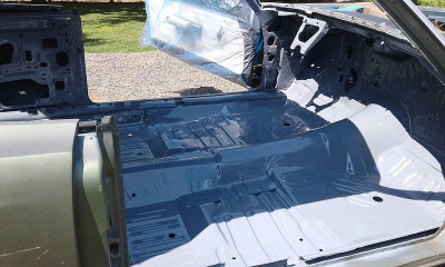

She's back safe and sound! And after about 5 hours of clean up it looked like this ->

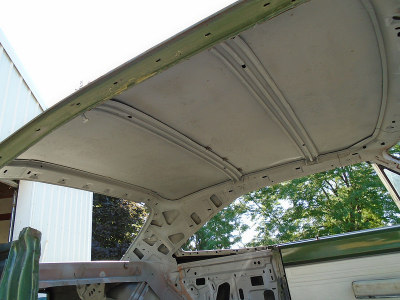

Roof turned out good!

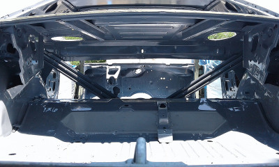

Wasn't entirely expecting this, but hey nothing time and money can't solve->
In the morning, we're spraying everything throughout with Rust Proof M/D. I'm told it's awesome stuff so we shall see. Pics to follow...

The roof always has some kind of rust, when they dipped these things in primer it was meant for the lower chassis. Were you able to see how far up the firewall the prime went before you media blasted?

looks pretty decent inside. minimal floor rust, not bad. now take a lot of pictures and send them to Russ. they will be a big help to him.
7,716
3,254

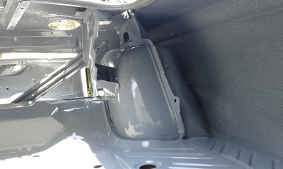

Thanks for the pics. Like them. Yep past most of that. But will use these pics for reference. Wish my trunk hinge brackets and extensions looked that good. Looking good Compsyn. Russ. :thumbsup:

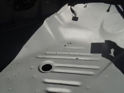

I used POR 15 on my inside floor pans and trunk section and inner fenders before painting
