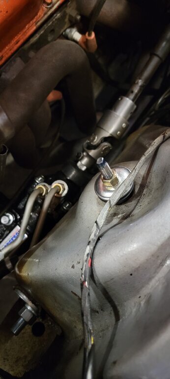

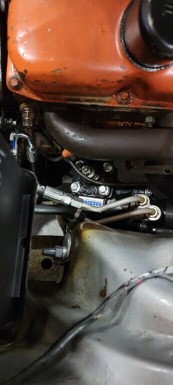

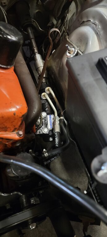

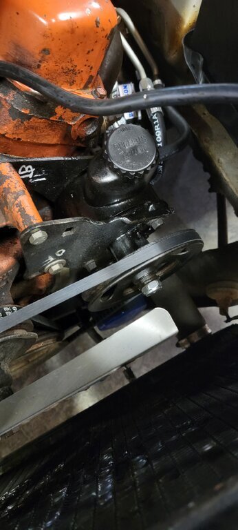

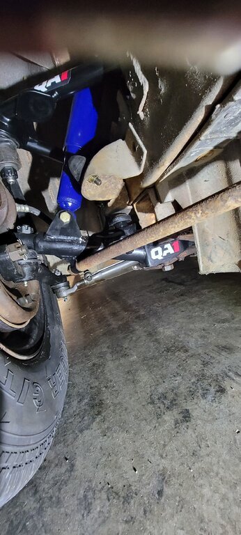

I ended up putting in the borgeson power steering box and power steering pump. Very nice piece and smaller than oem. Also installed QA1 upper and lower control arms and new shocks.

How much did you have to disassemble to get it done?
Not bad. Pulled the whole steering gear out and the old power steering pump, pittman arm and headers. I had to cut 3/4 in off the Shaft for the borgeson.
