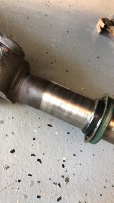

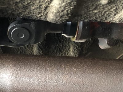

image.jpg Hey guys I got a little drip from the back of my transmission.
I was going to take the driveshaft out and see if I can replace the seal.

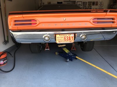

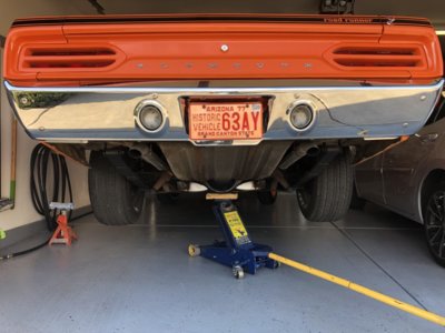

I just fixed my jack so I can jack it up really high now before it would only go up enough to barely take the tire off.

The seal looks beautiful I wet sanded the yolk a little bit to takeoff a little bit of wear marks,I guess the seal just wears out the chef seems to be tight in the transmission not much wiggle
7,715
3,253
While you had it out I would have replaced it with a new one. That is the norm when removing a seal. It is up to the owner if do or don't. Well it looks like your making progress buddy keep up the good work. Russ. :thumbsup2:

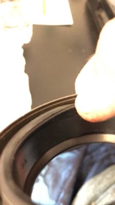

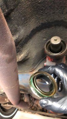

630671D1-2F89-4908-A636-2D3BE0CCDF6A.jpeg Oh no I’m definitely replacing the seal I just said it looks like there’s nothing wrong with it but at closer inspection you could see the cracks around the edge of the rubber
