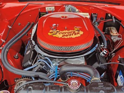

Rubber grommet, metal washer, nut, and a locking speed nut. Should all come with new shocks.
Here is a picture I found.
