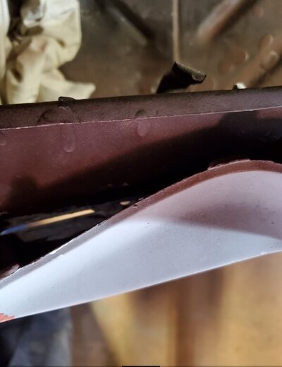

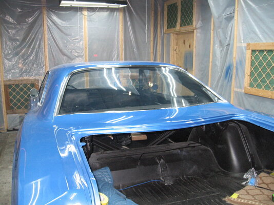

After replacing partial quarters, I'm wondering how well the factor seam fit.
I recall sealant on the inboard area butting the trunk gutters.
But what about out board.
Please take a look at your cars and see if the factory used sealant on the outboard sides?
Curious.

More "stupid" questions.
It looks like
1. These weren't sealed to the housing?
2. If they weren't sealed couldn't water get into the area and are the bottoms left gapped to allow any water to drain out?
(See daylight looking down,)
No wonder rust was a problem.
7,716
3,254
Use seam sealer on them. Also use RVT around the taillight bezel. Rust is a possible culprit like you noticed water got in that area. Figured it also contributed to rusting out the trunk. They really did not seal up that area very well. Put body filler in that area and got rid of that line as well where the filler panel goes behind the rear window. Mass production and engineering did not cover stopping rust areas. As you have noticed.

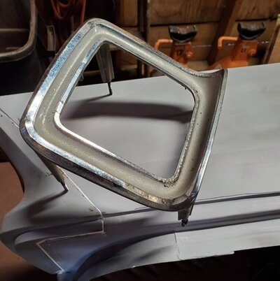

Had the taillight bezels chromed original ones. After market stuff is not the same. Then put the paint on from for paint one makes it in spray can. Have to order way head. Trying to find a chrome shop was a challenged. But found a good one but quite far from my home. Space coast chroming about 75 miles from me. This all went down during COVID. So had a long wait due to everyone was taking their stuff in to be chromed. They had the time and were working either on their boats or cars. So, took longer than I figured. But had all this done while doing body work and paint.

They make a black gasket but I don't know that the factory used them, never saw them on the old painted cars

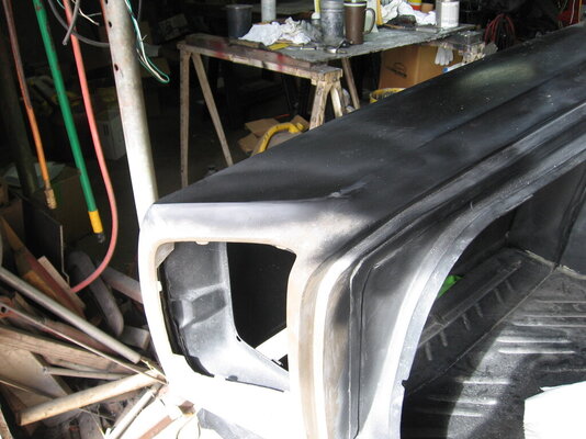

IMG_0109.JPGYou can see here how I filled the gap with body filler after installing gasket and sanded also primed for paint. Filling the trunk inside seam was a pain. Outside also smooth finish. You can see the gasket in the taillight bucket. IMG_0110.JPG

Below is a picture of an original paint 69 A12 RR at the tail light bezel. I hope this helps.
D
That's what I remember on disassemble .
I had a gap with sealant on the inboard side.
Very close fit on the top and outboard.
Those two edges on the mating of the housing have a slight groove that I had to clean a very small amount of sealant from.

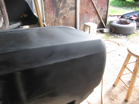

Great picture showing the factory quarter has a radius and not a sharp break over.
My Year One replacement panel skins had to be cut and welded to fit here.
I would term them "3/4" panels.
Not full quarters but not just side skins either.
