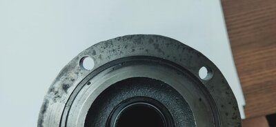

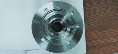

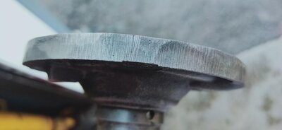

It seems as though someone has, at some stage, "clearanced", and I use the term loosely - the bearing retainer from the front of the box. For what reason, Ill never know. Maybe to get it into a different bellhousing?
I thought at first maybe the bellhousing was warped or something, but a quick check of the fitment of the retainer from my old 23 spline box - real snug - confirmed that it was the retainer itself. The photos show just how bad the "clearancing" was done.
Anyway, I ordered a new billet steel one from Brewers, and it fits - real tight.
Just goes to show, you really gott be checking EVERYTHING, even the stuff youre not swapping/replacing/maintaining.

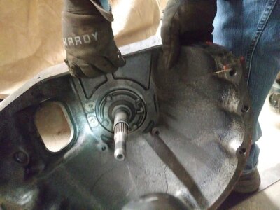

Looked it up. There are two front bearing retainers. One is 4.805 in. Other is 4.354 in dia. Some body must have had a bellhousing for the smaller dia and clearanced it to fit. We tried the bellhousing 2892282 on a 23 spline tranny and has a big gap on it.20210313_101600.jpg
