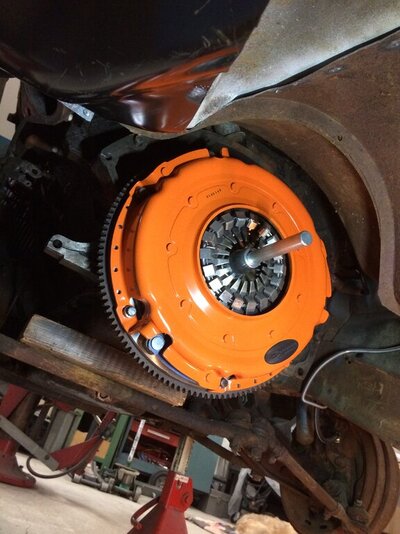

I used the centerforce and I love it. It handles anything I throw at it, and I’m known for my “spirited” driving.

Did not use the fin type pressure plate. Did not think I need the over center spring to help with the clutch but ended up putting it back in the car. Now better on the old Knee. LOL. Have 383 four speed with 450 HP under the hood.
