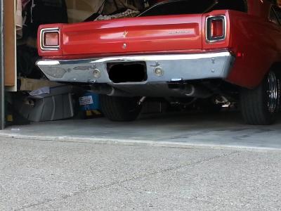

As far as drone goes, I had massive drone from my super 44's even with the H pipe. I resolved it by taking a play from the Hemi cars playbook and used resonators at the tail pipes. In fact I used (simply because of preference) Jones 18" x 3" glasspacks on each side. Drone was basically eliminated inside the cab and pushed it all out to the rear where it should be. with no sacrifice in power or torque.
Here is a shot of them. my set up is 2" TTI's ceramic coated to 3" pipe to 3" flowbastard super 44's out to these 3" jones glasspacks to the OE tips. Its pretty calm at idle at a stop but man drop the hammer and holy smokes it's like someone just set of a baby nuke lmao J/K it's cool though. I have a video somewhere if interested I can dig up.
