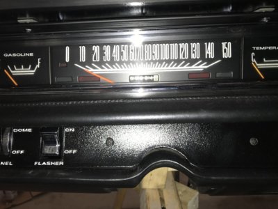

    This is the one in my car is it a gtx one?

    I installed the early production 150 mph speedo in my 69 RR, wish I had the later single digit one. Your information is correct, I'm sure you know. Right out of the B-body restoration book.

    Oke can i change the front lens to get it correct?
    Think i leave it like this
    Many suprises on this car

    Using the 120 lens on the 150 speedo no. It will physically fit but not be correct on speed

    Yes it is an early 68, and looks great, try driving down freeway with a friend in another vehicle ,having him drive 55 and you pace beside him for a stretch and see if yours is showing 55, if so (If it were mine) I would leave it alone, but it is up to you.
