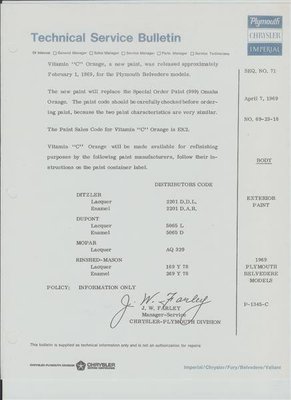

So this means that I could actually have ANY COLOR on this car as long as it is one of the COLORS available in 1969.
No, you literally could have ordered just about ANY color (Ford, GM, Porsche, Kenworth, whatever...) so long as it was commercially available. Wasn't limited to the available Chrysler color palate. You just had to pay for it...
The match up paint I had mixed a few months ago, for my rock chips, is called "Omaha Orange" but I believe in 1969 Plymouth called it "VITAMIN "C" Orange".
No, these are two different colors. K2 (Vitamin C) has metallic. Omaha Orange does not. K2 was one of the spring colors introduced when the A12 cars were released.

Though K2 is not specifically related to A12 or A14/A15.
