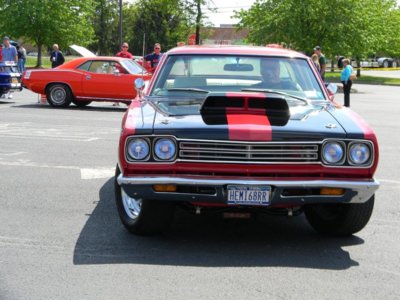

I am sure they could build you one .....you should buy the hinged bolt on hood......this is a quality hood....perfect fit....this is mine ....flat hood with a 5 inch 6 pack scoop.....he has 3 inch also.....years ago i bought a crap 6 pk hood for $399.00 and i could remove and install myself....i had to have 4 pins in the front to keep it from blowing off doing 130 mph at the track18595405_1806652452996369_2615871273388918459_o.jpg
7,696
3,231
plus I use the factory latch with mine.
Back up latch is always good. We always kept the original latch plus the hood pin's. It is no fun having the hood slam the front windshield. Never had it happen to me but have seen the after math when one did fly up. Not a pretty sight. :steering:

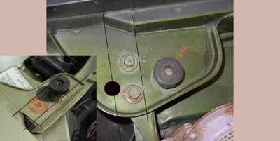

I am also looking to replace my factory hood with a fiberglass one to accomodate a tunnel ram setup. I am going for the lift-off hood, just becasue i really like the look of them.
Anybody ever done this switch before? Ive found the brackets that replace the hinges for the rear pins at classic industries, but am having trouble with the location of the front pins, as the mounting position looks like its on a bracket that is maybe unique to the 69 1/2 A12's?
Any help much appreciated.

found this photo for reference 68 on the left, 69 on the right. seems the fender pads are not interchangeable. Just wondering if anyone else has done this swap, and if so, where/how did you mount the pins?68_69_pad_001.jpg
