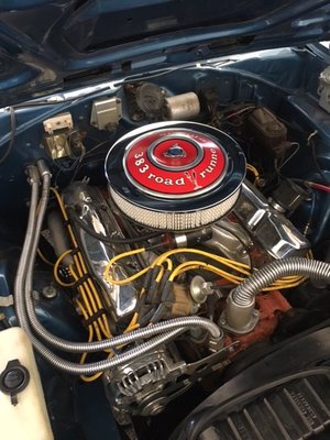

    1970 Road Runner runs great but after it gets hot I can crank it but it won't fire. I replaced the ballast and change the module to a 5 pin ( read somewhere that if you have 4 lead ballast you had to use a 5 pin module). It worked better but now after hot it starts, but if I let it sit for a minute it won't. Sometime when I jiggle the key while starting it will start and was going to replace the ignition switch next. But this problem has to be heat related - anyone run into this before? Driving me crazy...

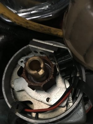

    IMG_2665.JPG Thanks John. Got out my meter and it 'a shot. Opened distributor and check out pickup - was going to take it out and get a new one but it wouldn't come out (need to study that one). I did notice that the wire coming from the distributor was pinched between the distributor and hot water hose. Pulled the wire to look at it - looked ok - reinstalled it and now it won't start at all. Think I'm getting closer to the problem. Will let you know what happens.

    Could be a broken wire where it was pinched. Big is the man. Have had bad coils in past motor would run grate and just shut down like you turned off the gas. Other ones would crank the motor shut it off then would not start. The Ignition coil can drive a man nut's. So test it like john said if it reads bump it or shake it to see if it has an internal bad connection. From now on I just get a good one and replace it. Oh I would clean that firing cam the points look dirty to me with some emery cloth. Might help make better contact. Russ.

    Thanks for your thoughts Russ. Progress for the other day. Talked to my son and told him I thought I had the problem licked/identified and we should focus on the pinched wire idea. He looked at it and found that I forgot to plug in the distributor connector. I felt so stupid especially after telling you all how smart I was. The car started right up - the good news is that the problem has gone away for now. It will be back. Russ, the first thing I did was replace the coil (forgot to mention that). I'll clean up the cam like you suggested. I put this car up for sale the other day, but today I was reading about the 392 Hemi conversion - that sounds like fun. And maybe my distributor problem will go away. Anyone out there need a 383 - runs great??
