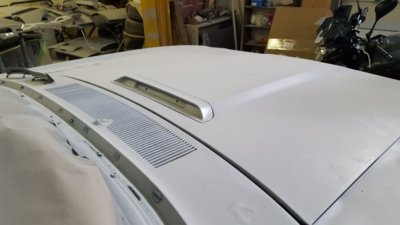

I just used pieces of sheet metal and bent and welded them in. don't try to do a big complicated piece, just break it down to more manageable shapes and weld away.
7,704
Where are they and how big. I replaced the hole top upper cowl and lower on mine. Thought it would be quicker. I had a lot of rust in the lower cowl so did both. Had to rebuild lower A pillar post where it goes under the upper cowl. The older metal can be a bitch to weld. Wonder how you clean the inside when done welding. Yes just do small spots if possible . What you have done looks good. Russ.

Thanks it was just sand blasted and then epoxied and then primered

It was sand blasted and then epoxied and the primer was paint on and what you see it what it truely is

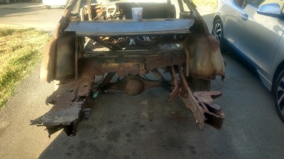

I don't see much rust, let alone anywhere where I would be worried about replacing things. If it is worrying you too much, I agree with Russ on this, just replace both panels. I tried to separate the top cowl panel from the bottom, and it didn't go well. I wasted hours trying to do it, and ended up just having to replace both. If there is just some pin holes, I would just plug them up with weld and grind it smooth. It is a fine body to start with from what I can see, much better than this:
pbBbdFF_bYMVf-SEZ9jvLGRAq55y9f6yNhBVcXvJuxXTdm-GT_dyz2is4ZOmyuCHZfK9KoAFeYqjJxvRYw=w1625-h914-no.jpg
-Mr. Moe-par
1968 Road Runner, 1968 Coronet, 1968 Coronet, 1969 Dart
7,704
