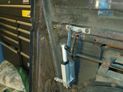

    I converted my air grabber for vacuum actuator to a 2" 12 volt electric actuator. It works prefect.

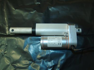

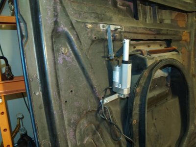

    Converting Air Grabber From Vacuum to Electric

    Thank you. That looks like a simple solution to the problem.

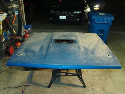

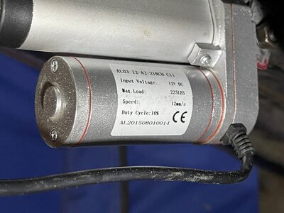

    Birdofprey is back!!! I’ve been recovering from prostate cancer and had to devote all my attention to healing. It’s under control as of 01 Jan 2021. “HAPPY NEW”. I’m uploading a picture of the actuator I purchased on eBay, and you can see the model number.
    I need help with finishing the switch that will operate the air grabber. Furthermore, I plan on using a DPDT switch to operate the actuator. Also, I want it to look stock on the instrument panel, in the stock location. I’ll convert the original vacuum switch, by modifying it to operate with the DPDT switch. It will work in tandem with the modified original vacuum switch.

    Ok I'm not an expert on actuators. I measured the operating opening and closing strokes and discovered it was 2". I purchased the one in the picture. As you notice it has a 2" stroke. I understand this actuator has internal extending and retracting stop switches.

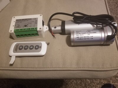

    I am doing the same. I have the complete setup but don't want to deal with all the vacuum lines and relays. I took your advice and ordered the same actuator, you can get them on Amazon. I also ordered the remote control for it.
