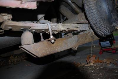

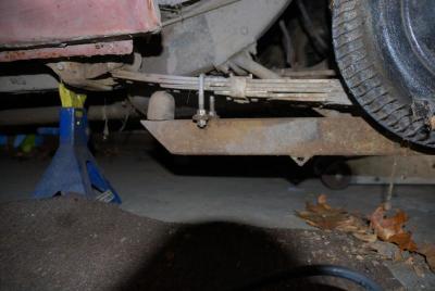

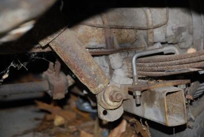

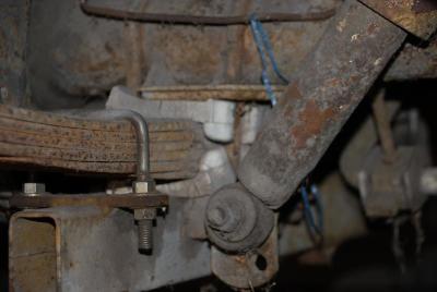

Here is a quick look at the old configuration. I am changing my mind again and may go with stock height for road handling.
Also have to get the isolator pads or I have to change the brackets.
ah...the pics wern't working last night.
