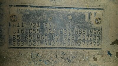

Hey everybody! So I just bought my first car to restore, flip, or what have you, and I am a newbie to this. It's a 1969 Roadrunner Convertible 383 stick shift. I tried typing in the fender numbers online, but no luck, and I didn't know if you fine people would be able to point me in the right direction via a website to decode it, or decode it for me? Looking at mine verses others online, mine doesn't have any numbers or letters at the top of the tag, which confuses me? :). Here's the numbers and I'll attach w the spacings and all as it appears on the tag:
A36 M31 R21 VCW 26 END
B5 B5 H2B B7 B23 05 7177
563 D21 RM27 H96 174331
Also does anyone know where to find the builder's sheet in the car?
Your convertible very similar options as mine. Try this site to decode your tag.
http://www.passion4mopars.com/1969-1971-Fender-Tag-Codes_b_25.html

Got ya, thank you! Do you know a site I can decode the fender tab (I think that's what it's called?).
It's called a Fender Tag. Also - on the bottom row, the second group of alphanumeric digits from the right are "H9G", not H96. G is St. Louis where your car was built.
RM27:
Plymouth Belvedere,Satellite
Medium, Road Runner
Convertible
H96: 383 330HP OR 335HP 1-4BBL 8 CYL
1969
Newark, DE, USA
174331: Sequence number
563 : Unknown
D21: 4 Speed Manual Transmission
B5: Bright Blue Metallic Exterior Color
H2B: Trim - High, Vinyl Bench Seat, Blue
B7: Medium Blue Metallic Int. Door Frames
B23: Build Date: November 23
057177: Order number
A36: Unknown Top Color
M31: Belt Moldings
R21: AM/FM Radio (5 1/2 Watts)
VCW: Unknown
26: 26in Radiator

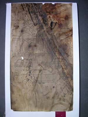

22,143
2,351
Its pretty common some cars don't get one and others get several from other cars. A friend of mine found 3 sheets one being his and two from other cars. I found this under the carpetroadrunner restoration 010.jpg
