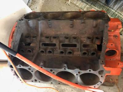

    The same guy who's selling the 69 Bench seat is selling this 383HP Block. Casting date 3/6/69. $350 + the ride. He didn't respond to the request for the VIN

    Never mind block is ok I found they are cast that way

    Sure is......

    Bores starting to get rusty as well

    OK, probably a dumb question, but could something like that be repaired or is the block toast?

    My bad. That's how they are casted. Memory failure

    You would need that piece to weld it back into place. Makes you think what would cause that piece to be broken in the first place. Yes you can weld cast iron. Their is a new rod sold for Tig welding Cast Iron. You have to know how to weld cast iron. It has to be heated up before welding and no air can blow on it while welding then let cool slow and have to lightly tap that area during cooling. It takes a while. Mr Tig has a video on this method. He dose work for Jay Leno. Had a block a connecting rod broke and punched a hole through the side of the block. This older guy said bring it to me and he welded a piece of steel plate on that area. It held and the motor worked just fine. Russ. :beep:

    Well the only real way to weld cast is to heat it till it’s red hot and keep it hot while you weld it you really need to know what you’re doing I mean you could half way do it but it won’t be right

    I agree with you Dmartin. Not for the amateur welder or beginner. I have welded a lot of pop metal and think I was tough by the best of the best. Yes has to be hot but not to the point it is melting. Hot enough to open the pores in the metal. Tig welding is the best way to go but the metal needs to be very clean. Use stainless steel wire brush not a steel brush. Use acetone to clean the metal well. They have a new rod a guy has put out that is not silica based filler rod. I bought some to do the bell housing has a small crack at the top. If you check out Mr Tig. on the web he is very good J Leno uses him at his shop when he need's the best to fix some thing. They welded up a motor case on an expensive car and it turned out fine. Just my thought's and what I have done over the year's. Russ.
