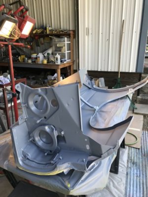

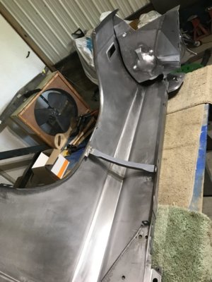

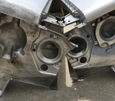

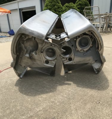

Gave up on the aftermarket fenders that I bought, (just couldn’t get them to line up like I wanted) E5D88A9E-9D6E-43F4-8A71-48297782E247.jpeg E5D88A9E-9D6E-43F4-8A71-48297782E247.jpeg 8D1786BB-7715-410F-8DD5-29A46B5D26B1.jpeg 4D51390F-6DA2-46F0-BD4E-A3FA130B3356.jpeg pulled out the old rusty fenders I had taken off, patched and welded and made new headlight buckets! Took forever, but back in the race!

Go get them Big Block. Yes working on my 50 year old fenders also. After you talked about how bad they fit and other comments from people. Had a donner fender think it is off a satellite. But it lined up nice when test fitting things. It had layer after layer of paint and primer. Stiped both of them with air craft striper. Could not get into places with the sand blaster. Keep up on it their buddy. Making head way. :thumbsup2: The head light bucket look's grate so do the fender's.

Now I will start on the right hand fender. will do some more work over on the left fender but it is primed and looks good and will help keep the rust down.:thumbsup:

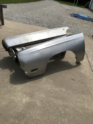

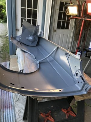

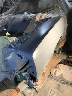

Welded in the homemade headlight bucket, sandblasted, sanded and welded a rust hole. The right fender went much better than the left. 2F3E2D76-340D-4684-A7F6-547B3AAEE721.jpegB2F4663B-C894-4D6A-ABC9-D7BDA80861A5.jpegB88EBC8B-CE24-40EE-9FD4-88352685902F.jpeg

thanks Russ. Yeah I'm happy with the fenders now after lots of work. good luck with the buffing, you can do it!
