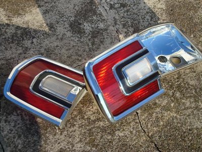

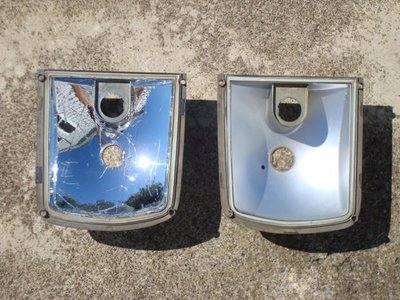

I did this to my '68 road runner taillights because I just didn't think the standard reflective finish was really all that reflective. It's pretty inexpensive to do but a little time consuming but when you see the results day or night time (brake lights especially!) you'll wonder why they were not finished this way in the first place. (maybe they were and I just never have seen new taillight assemblies :D)

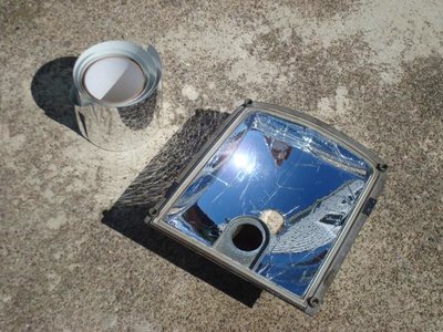

The chrome tape is available at a lot of national chain auto parts stores or online and not too expensive. I cut pieces of think cardboard or heavy stock paper to make templates for some of the reflective areas and used some blue light adhesive masking tape to get preliminary shapes of the curved areas. I should have used some window cleaner to wet the area to be able to move the chrome tape a little (like putting decals and how we put motorcycle graphic kits on race dirt bikes) but maybe when I do the A12 runner or the GTX I try that and report back.
Someone said that with this reflective tape and some LED bulbs it should be really bright....I know for sure with just the OE 1034 incandescent bulbs it seems many times brighter day and night.

Did this mod yesterday, but I have to admit, I did not notice much (if any) improvement (I was hoping for and expected much better results), which leaves me to wonder if using crinkled aluminum foil with it's many reflective facets might not have done a better job? Doubt if I'll ever find out.
