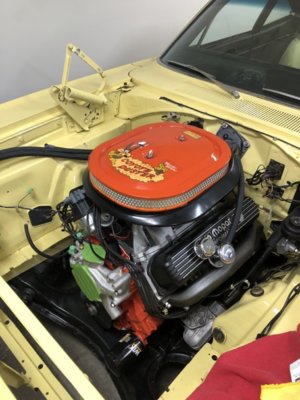

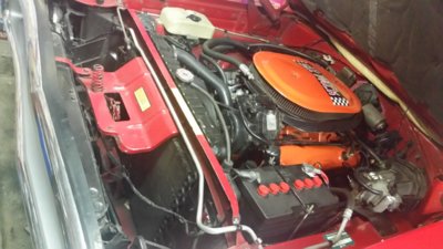

You are right, they are not the same colour. This lid has never been painted and you can clearly see its different. The blocks on both of these engines are mopar brand aerosol based ‘street hemi orange’. I think the aircleaner lids may be mopar ‘race hemi orange’ but I am not 100%sure on that. I may buy a can of ‘race’ do a test swatch and compare..
It’s not the easiest to see but you can discern at difference in shade.

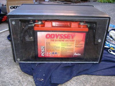

Mine is not a topper. It is an old (dead) repro battery. Gutted and has a lightweight racing battery inside of it.

I have done 3 like this now. Going on 6-10 years on each of them now (depending which one). Lasts much longer than the repro batteries. And less than half the price.

Yes, it makes a mess. I turned the battery upside down to let it drain for weeks before I could get around to it. Then cut the bottom out and start taking out in sections. The battery is molded (made) around all the plates and dividers. It takes a lot of time and effort to get it all cut out trying not to damage the outer case.
