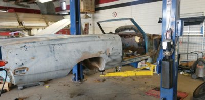

37C3D723-007A-4861-ACAF-796CD3F545F3.jpeg just starting to refurb every single piece on my 69 roadrunner convertible. It’s 100% apart and on rotisserie so....

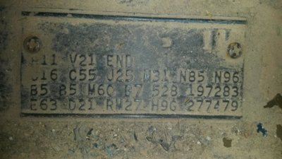

Interior paint? Trim tag picture shows B7 I think for interior color. Are the door tops and dash B5 or B7. For the interior panels that need color, what is recommended including what paint? Year one has a blue metallic I think, is this the correct color?

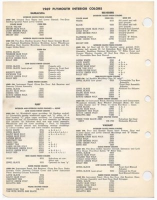

Your door tops are B7. Dash frame is Baltic Blue Suede - it has a slight texture to it. Nothing in the interior is B5 on a car with a B7 interior. Please refer to the interior color chart below for specifics on each component. I got my paint from Chas Dallas @ www.8774paint1.com. He can provide everything you need by the pint, by the quart, or in a rattle can.

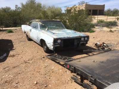

Thanks, yes I have been after this one for over 20 years. Guy who “was going to restore” finally called me a couple months ago. Bad part it was parked outside in Az heat for about 25 years. But it is very restorable. Known rust is one quarter and maybe trunk. Soda blast in next 10 days then get body panels done. I have to touch virtually everything, well into that already and have all of the unobtainium parts. Some good others can be restored.
This is where I started.....

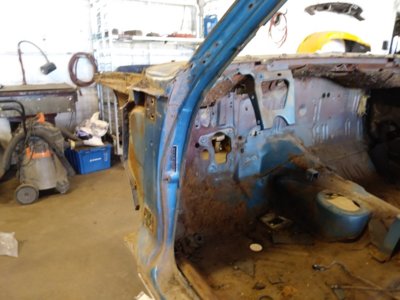

09B0B231-5EE4-405B-A6C9-904FEDCEF091.jpeg 9F9B279A-C4EA-4086-9D16-843595A0D4D1.jpeg I got pretty lucky with this project. Getting body done is going to be $$$ but I have a good guy doing the work. Really solid and now not a bolt left untouched. Passenger 1/4 repair done years ago is a bit of a problem as they used a coupe 1/4 and a lot of bondo at top. Metal fab required. Rest of the car is very solid...only rust repair is trunk pan and lower 1/4 on driver side. Missing parts or parts still needed is a rear boot well separator as mine is badly bent up, front window pillar moldings which I don’t think are reproduced...mine are pretty bad but if I have to I’ll spend days working them.

Yes, 4 speed console car. I do need to buy the repro plastic console housing. All the metal is good though luckily.
