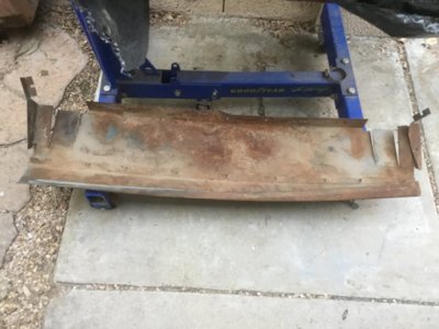

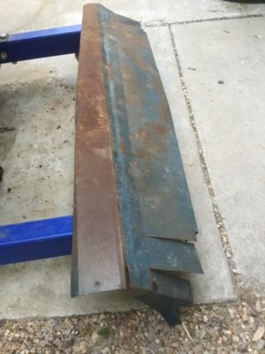

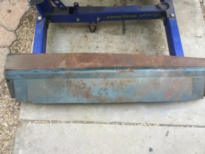

116268A3-732C-44B7-813B-EEE666E902DC.jpeg 0784D7DE-E1BA-4F7B-B65B-DFC464533E8B.jpeg 051227EF-D1F2-4A8B-A803-364C3692A6F7.jpeg i believe this installs over the rear seat rail. Am I right? But it’s bent up good and I need to fix that. Would anyone have a picture of this installed or not installed?

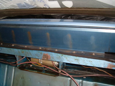

That's a finish panel that attaches behind the rear seat. There should be a strip to attach the Convertible top boot running side to side. Painted interior colour.

Thank you for the picture. Yes that’s it. I found a couple on eBay but for 67’s. The piece that mounts to the top of the seat frame is what is bent on mine. I think I can remove the sheet metal and use the 67 piece and will be ok. The sheet metal is good. I could probably even make that piece but....
