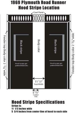

I know I saw something on here about the measurements and locations of the stripes, but can't find it now. Getting ready to paint the stripes this weekend, can anyone clue me in? Thanks!

Thanks! This is what I saw the other day! But how about the part where it curves back into the car at the back of the stripe?
I believe it just follows the lines of the cowl.
