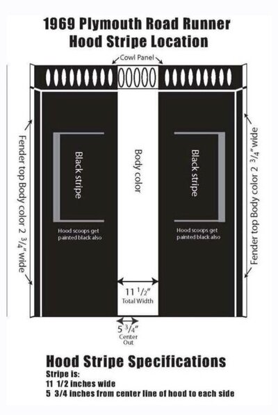

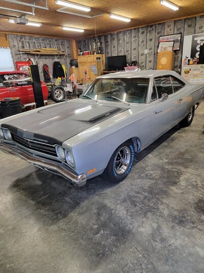

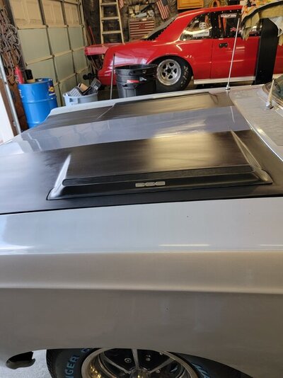

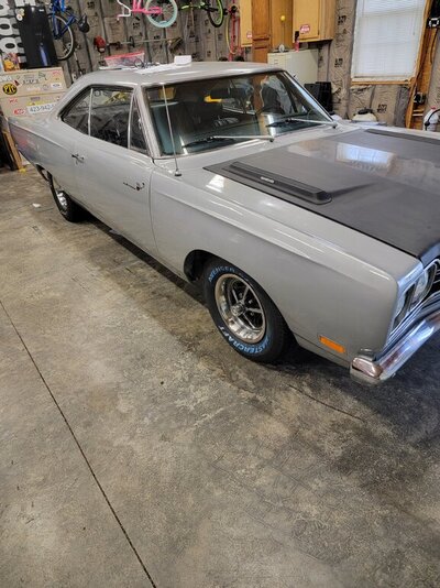

My roadrunner came with a fiberglass hood with scoop. I bought a proper hood for the car that has the stripes. They are a different type of "tape stripe "
Where do I purchase or what do I purchase for the fender to make it right?
See pic

Very difficult to get it to look good on the fins of the cowl. Even more difficult to get it to stay on in that area as well.
