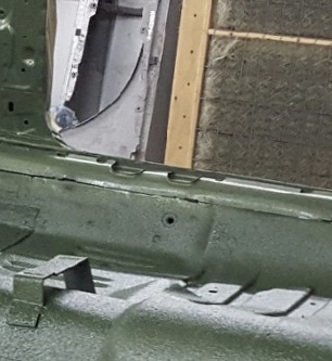

I installed the head liner and forgot to mark seat belt anchor points going to use aftermarket 3 point belts , I can see the 2 at the hump ,but can’t find overhead or lower outside mounts ,any pics would be appreciated
724
Can’t help with overhead but here is the outside driver side. Passenger side should be in same general area.

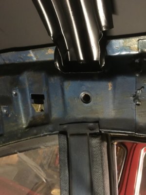

Here’s a photo of the upper. If you need any others or measurements let me know....Jim

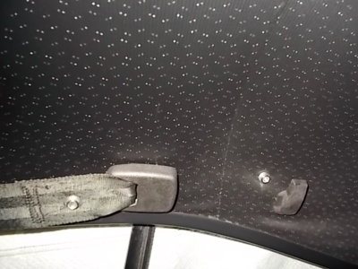

Is their something near the sun visor also. I have a stainless steel pieces I got form one of our member's that sold his runner. Just asking.
7,705
I had seen a picture here some where's before if I am not wrong. May be someone will post one of the location for that part. :thumbsup2:
