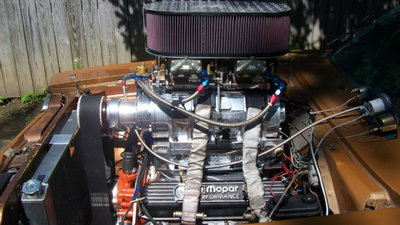

the blower is a blowershop 8-71 10% overdrive with 2x1250 carbs on race gas and an air to water intercooler with factory iron 346 heads ported,koleno performance cross bolt main block o ringed,eagle rods,wiseco pistons[8.5cr]built 727,billet drum4 pinion sungear,rm valvebody.the car/driver weigh 3900# ran 10.14/136 spinning in the 60'i will digup some more pics in the morning.

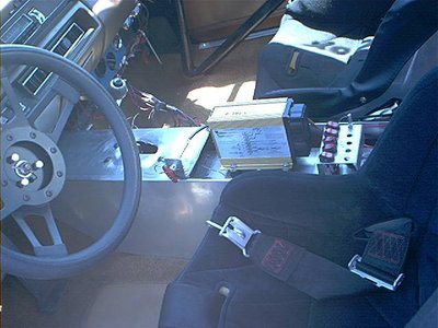

i am thick skinned so you wont scare me easy.Thanks for the welcome!the car is not tubbed,the rear seat is out due to the 8pt roll bar and the heater a/c box it out in storage.the car was a factory 318 a/c car from North carolina that my brother baught from a used car dealer in cleveland ohio and after he blew the engine and switched to motorcycles i got from him for 1800$ to help me keep busy thru my divorce and the car is still here.;)
