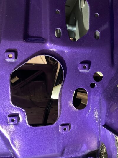

I have managed to figure out what every hole and cutout is for on my '70 RR. EXCEPT for one! It is a 4-speed, w/ air grabber, no a/c, manual brakes and steering, Rallye dash w/ a 440+6.
The hole I cannot figure out is stuck between the speedo hole (7/8") and the oval cut out for the clutch rod boot. It is .406" (13/32") in diameter. Can anybody help determine what this hole is for?
Thanks.

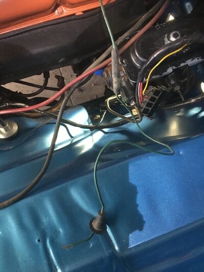

Hi,I’ve got a factory 70 383 4 speed car.

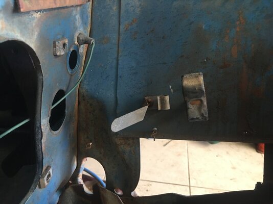

I’m slowly restoring this one.I will see if I can find out where it goes inside the cab

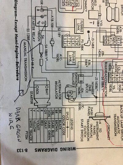

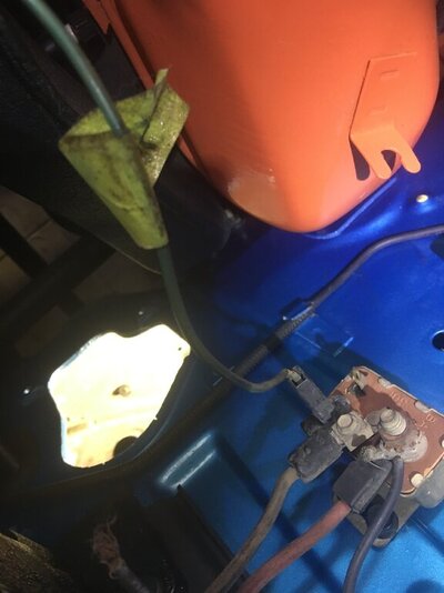

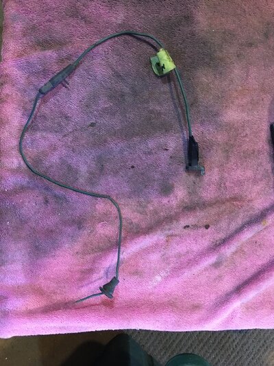

Yes that is it! It is the wire to the clutch switch for a '70 4 speed. Clutch has to be depressed in order for engine to start. The hole size on mine is .455". See attached picture. It is in a different place than your but looks to be in the same general area. Maybe was changed during the year of production.
Thank you for your pics and input!!!!

Looks like I may have the only '70 RR with the clutch switch wire hole between clutch boot and speedo grommet. Every one elses is above the speedo grommet. Does that make mine more valuable?
