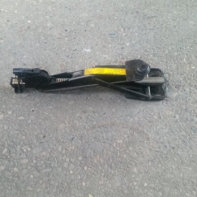

mopar jack
Jul 24, 2019
71
66
I have two 71 plymouths and I stored the bumper jacks years ago. I like this jack that one of my chevy friends showed me and were available at pick and pull. The jack is easy to use, no fluids to leak and is very stable if you lift at the frame or rear end
