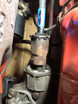

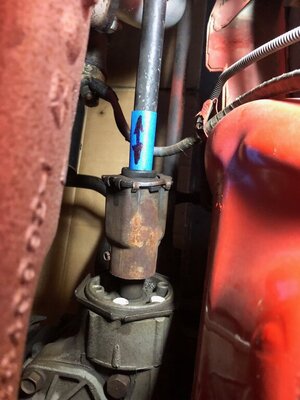

I dropped the steering column to remove the instrument cluster at which time found that only the 2 nuts on the studs were securing the column (3rd lower bolt missing) and that they were not centered in the rectangular breakaway plastic washers, were towards the steering wheel end (and breakaways broken). I also had to remove the 3 bolts down at the firewall to get it to drop, which I thought was strange. I bought new breakaway washers and can pull the column closer to the driver to better center the mounting studs in the 3 breakaway washers (still not quite centered but closer) but then the column shaft is farther out of the gearbox. My question is does it matter if the shaft is pushed all the way into the gearbox or pulled out (it stops ~ 1" out) so the 3 column fasteners are better centered in the breakaways? I wrapped blue tape around the shaft to see the 2 positions (in/out) for reference…

need to make sure column is solid on both the steering box and in end of column. need enough of the connecter in there. other than that can put wherever you like it

Sorry forgot pics - What is the piece in between the shaft (marked with blue tape w/ arrow moves in/out) and the steering box? I would prefer to have the shaft pulled out of this piece (towards the driver) so that the 3 column fasteners are better centered in the plastic breakaway washers but don't know how it's supposed to be.
13,673
825
I agree w/ Quickie. That piece is called the steering coupler. It is keyed (slotted with square bushings) and the shaft can move up and down inside it. The breakaways are also slotted for movement, so there really quite a bit of adjustment in there at both ends. You can slide the shaft inside the coupler to see where it bottoms out at both ends and pretty much guess where center is. Personally, I'd rather have the shaft deeper in the coupler than rubbing up against the seal and retainer.

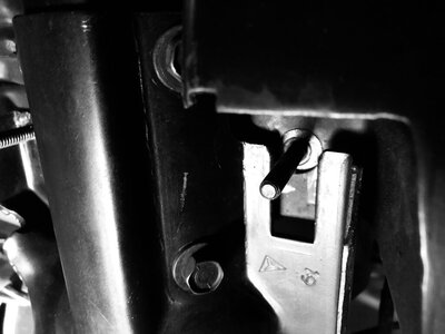

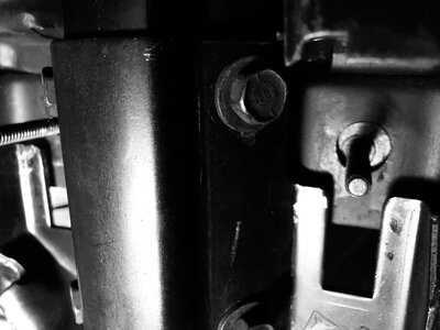

Me too but the problem is that under the dash where the column attaches via the 2 studs, 1 bolt through breakaway washers it is way off center (see pics in/out):
Pulled OUT toward driver stud is stationery (still not close to center) this is how it was and breakaway washers were destroyed:
Pushed IN toward firewall stud is stationary (shaft all the way into coupler but not even close to breakaway washer attachment)?!?
7,704
Is their any adjustment on the steering column bracket. It might be on up side down. Give that a thought. Some one might have rebuilt the steering column and put that bracket on wrong. :(

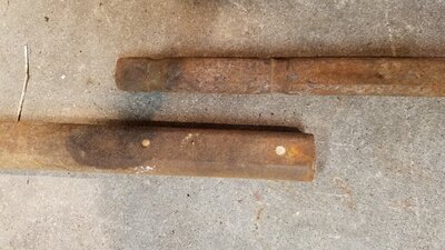

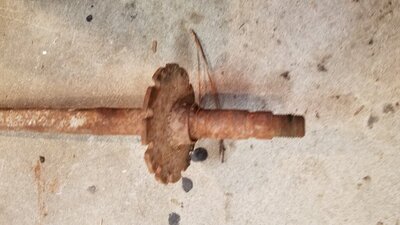

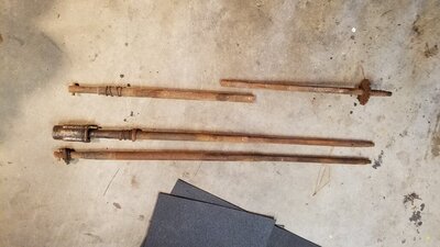

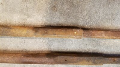

I'm sure I can post some pictures that might explain it tomorrow or the weekend more likely
I believe I have some sections handy from A bodies.
Rapid Transit
Just A Traveler In Time
Feb 9, 2015
458
439
Probably A bodies
Note one is longer.
Not sure.
Little plastic pins and indents.
Doesn't really do much.20200528_103200.jpg 20200528_103237.jpg 20200528_103152.jpg 20200528_103156.jpg
