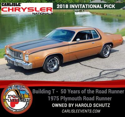

Goldie originally came with 14” road wheels. 225/70/14 tires are still available. I bought a set of Cooper Cobras from Summit a couple of years ago. I think that Tire Rack carries them also.

Since Goldie came with 14's, do you think 14x7's with a 5x4 1/2" bolt pattern and 4.25 backspace would fit bot front and rear? I like the Coopers and am considering them
