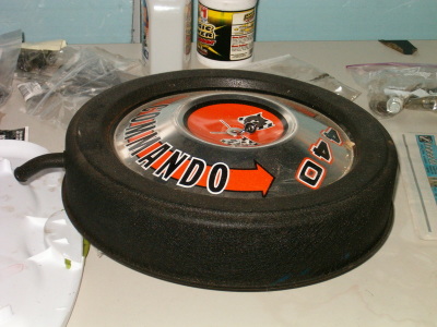

I have a 4150 Holley duel feed on a 69HP 440 with stock iron intake. Wanted to use this air cleaner,Just was wonder if there will be a issue with the stock hood clearance .Have not install motor yet

you are using a stock intake, and that is a stock air cleaner, so it should fit . install it, close hood gently and see if hits. if can't feel it hitting put some modeling clay or putty on top of air cleaner where you think it is the closest and close hood. measure putty and will tell you how much room there is.

Thank You !!! Great Idea, Just Painted the RR and will be checking this out !!!!! I have used Play Dough on other projects for the same reason just could not remember that !! Tuff to get Old !!!
