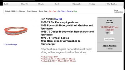

So I bought a six pack element from classic industries. It came in a box labeled Bouchillon Performance. The filter isn't even close to fitting my base. Its too long and also too tall, when I place the lid on top the studs do not even reach the holes. I am sending it back for the filter listed on YearOne. The year one filter says it will fit hemi, six pack and 4bbl air grabber cars. Sent one $140 filter back for another $140 filter.

There are several different ones, Hemi, 6bbl and 4bbl are all different

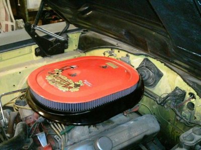

I went with the K&N for mine. Got it off the bay a couple of years ago, was under $70. Not stock looking, but for the cost I can live with it.Coyote Duster b.jpg

I am very leery of K & N. They claim "to achieve high, virtually unrestricted air flow", and most studies I've seen claim that they pass more dirt particles to do it. I won't touch them.

So is there a difference between a six pack element and 4bbl? I mean the one I had wasn't even close. Hopefully this year one product will fit!!
no...same thing, the base of the air cleaner is different(three holes instead of one)

I'm just wondering why this last filter fit so awful... Hopefully better luck with the year one product
I have a beat up old Fram filter, and the K&N I bought fits just as well as the Fram.
