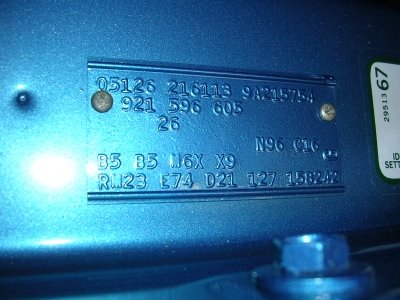

A GTX with Lynch Road build Fender Tag, doesn't have mutch on it.. Would it have had the Air Grabber Option noted. The hood on this GTX has the open vents ( I realize they may have been swapped out for the solid ones), It has no grabber under the hood now. But I see a dark outline around the center of the hood, almost looks like the shadow of a dark Rubber Material or something pressed against the hood. Is there anything else under the hood that would help me determine if it had a grabber.

You would find N96 on the tag for the option
Yea it wasnt there, just looking at the discoloration under the hood that looks like one was there, but I couldnt find the hole for a cable into the firewall. Thinkin maybe someone just put the open screens on the hood in theory to cool the engine bay.

One might have been added and then removed are there any rivet or screw holes

Does it have a 3-Speed wiper motor? Does it have factory A/C, even if the A/C system was removed the firewall and dash will have the telltales of having a FACTORY A/C system. You couldn't get the air grabber-fresh air package with A/C or without a 3-Speed wiper motor. Late to the party but just wanted to add this for future reference.

the outline could of been made by a hood insulation pad,,goes on with 15 clips,

does this mean that if i have a 3-spd wiper that my car could have had the fresh air package?
22,143
2,351
No. Because 3 speed wipers were also an option . Your fender tag from Lynch rd would show N96 if it had the fresh air option.roadrunner restoration 893 (400x300).jpg Here in my Lynch tag
