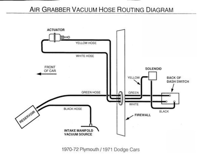

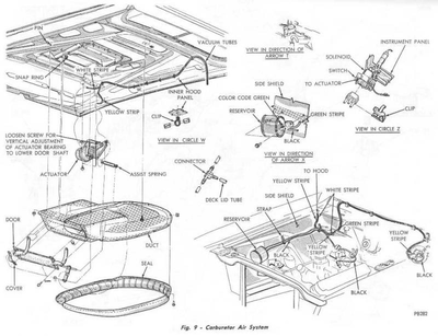

Did you just want to install a complete hood, or need help with individual air grabber pieces?
These drawings might help out a bit, but I think they're for 1971. For example, the reservoir should be on the firewall for 1970.
