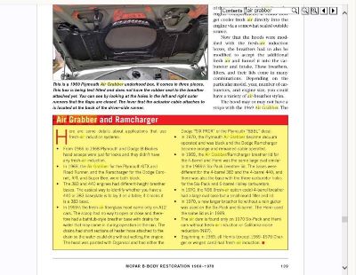

I just had a thought.
Is the air grabber the same as the ram charger?
If so, I could measure the ram charger on my 440
13,671
824
Same set-up, Fran. Just different decals. Here's some info from the 1966 - 1970 B-Body Restoration Book.
