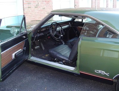

Here is a hurst v-gate shifter in my gtx...I like it....only thing i had to do was install a heat shield around the cable
now that has a nice "Vintage " look to it.
"Dear Santa"
6t9runner440
150
North Jersey
The reach isn't bad...kind of like a console car....just a bit lower but it's pretty comfortable...the only thing i'm not crazy about is you have to go to park to get it in reverse...but I think thats true with just about all floor shifters
