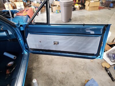

A couple questions, the dash, doors and all the plastic gets the B7. Was the metal bare interior color also B7 or the body color B5 in this case?

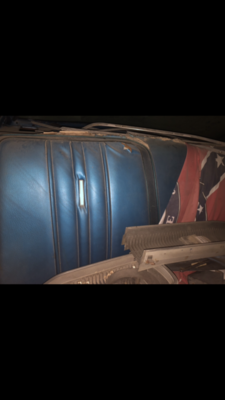

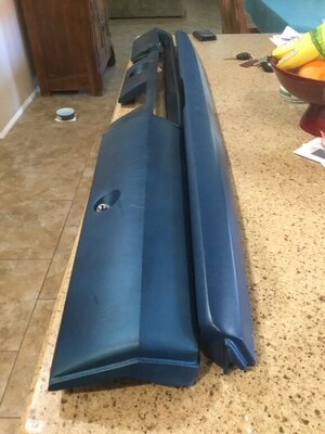

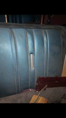

The dash panels I pulled out of the car were the lighter blue. Is that correct with B7? Or are the replacement parts (picture) the correct color?
They look B7 to me. On colored interiors the soft parts will differ in color some.

Jack - There are several color variations in play here. You can see most of them in the attached pic. There is no B5 in the interior. Your dash pads look to me to be the correct color for the B7 interior.

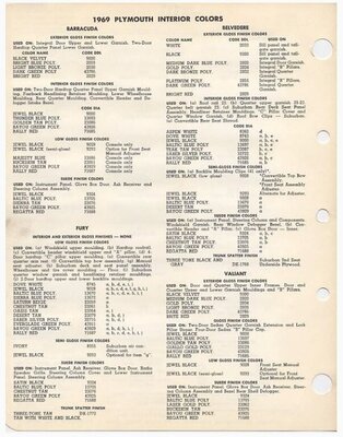

Dash frame, steering column, & ash tray are painted a textured, suede B7. The actual color name is Baltic Blue. See the attached interior color guide below. I got my paint from Chaz Dallas @ 8774paint1.com. Plastic trim pieces are also Baltic Blue, but in non-textured finish. I also got this from Chaz. The inside of the doors (and corresponding trim pieces on a coupe or hardtop) are all that are truly B7 Jamaica Blue. Ignore my painted door panel trim. My A12 is a non-A87 car and does not get the stainless trim like most people are accustomed to seeing in this location. I've already chased all of this down (David Patik @ Performance Car Graphics was a huge help to me - he really knows his interior stuff on B-Bodies) so let me know if you have any other B7 interior questions.
